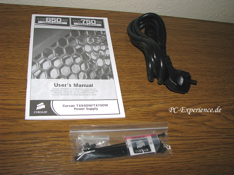

- Kabelbinder.
- Case Badge.
- Handbuch (5-sprachig).
